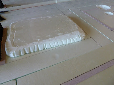

The surface is made from hi-density insulation foam, glued on a hardboard surface.
I added holes for craters and used cardboard for sidewalks.
One of the adjustments to the plan was to make some of the ruins removable from the table, or a least exchangeable.
To do this, I made a few hardboard cut outs. It is a bit thick for epic, but It's cheap and doesn't warp.
A hill (or the start of one, I'm not yet satisfied with this one, might need to make a new one

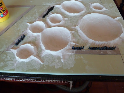

Started work on moddeling the craters

Wow, very impressive! How did you make the crater holes?

The Craters:
I first drew circles on the foam. Then cut the rough shapes with a Stanley knife. The next step was to sand them with some fine sandpaper (this is where the hi density foam really shines. You really don't want to do this with normal quality foam).
After that, I took some modeling clay to sculpt the crater sides. This has to dry for 24 hours, and when its dry, I will apply a thin layer of PVA glue, to strengthen the ridges and create a better adhesion with the foam.

Due to a spell of good weather here in Holland, I didn't get to do as much as i would have liked. Some scale 1:1 modeling around the house was needed, and I prefer to do painting with non acrylics outside as much as possible.
Anyway, I've sealed the craters and I've started work on the first ruins. I'm not sure if I want to give them a second sealing layer for extra strength. Any good tips?
