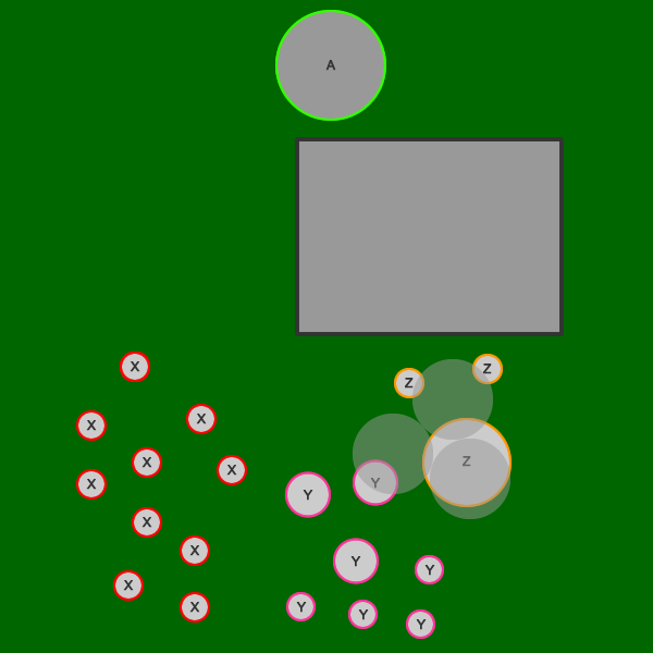

Given the following situation:
So we've got A facing off against enemy formations X,Y and Z. Assuming that the grey block is greater than 10cm deep and fairly talll, so it blocks line of sight, so the only formation visible to A is formation X. Am I right in thinking that the only possible way of laying down a 12BP barrage is something like this?

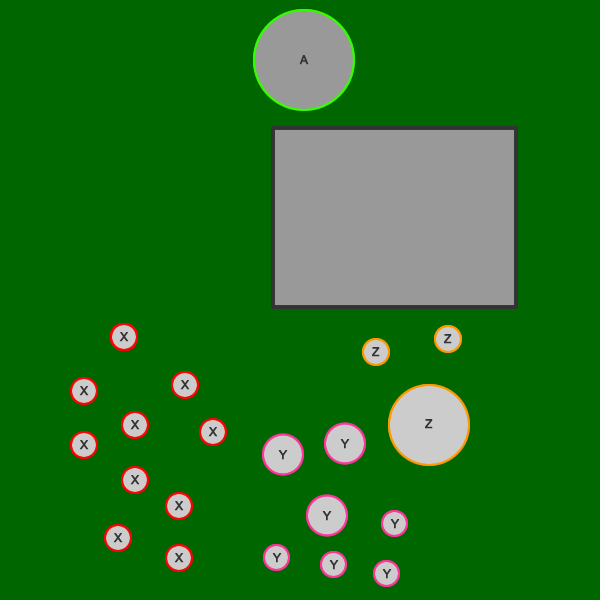

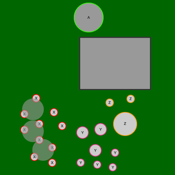

Basically covering as many units from the target formation as possible. Despite the fact that something like this may be tactically more advantageous:

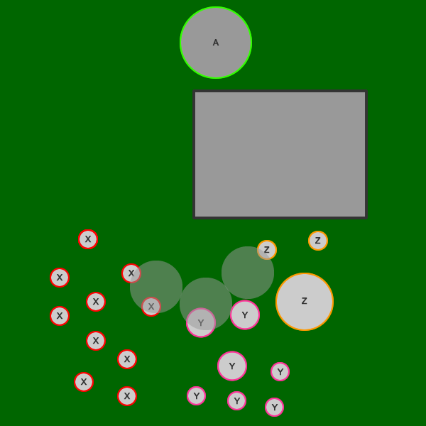

Given that each formation hit is going to receive 3 BMs just for coming under fire and that X consists largely of say, expendable gribblies and a large combined assault may be brewing next turn?
This brings up a couple of things:
1. Is it very likely that large barrages are ever able to target multiple formations, given that "templates must be placed in such a way as to get as many enemy units from the target formation under them as possible within the restrictions for lines of fire and range."? I'm guessing once all units in range and in LOS are covered you're then free to put the other templates where you like, so you could find yourself hoping to only be able to see one unit from a formation so you can immediately place other templates to catch a second. Come to think of it, how does this work for indirect fire? LOS doesn't come into it, so do you always have to focus on one formation? I can potentially see the logic from a game point of view, clipping two formations with a disrupt barrage for example is quite strong. But then it's up to the opponent to spread out accordingly...
2. It might be a +1 for using true line of sight? Unless the LOS blocking terrain is an actual building, let's say it's ruins, it's pretty unlikely that A won't be able to see Y and Z on the other side. This would mean you could target formation Z, and at least hit Y and Z and still be following the rules as written.
To me, the spirit of the game would suggest that the second barrage would be fine. They put themselves in that position after all and it is probably the best move tactically. I'm just interested as to how it would play out at a tournament or if I've just mis-understood the rules somehow. Also, it's not my intention to come across as at all gamey! I'm fine with the second option, it's just more epic!! I'm just interested to know how people play the rule. It'd also give better perspective on the pricing of barrage units.

Having re-read the rules, I have to say that the second example breaks the 'same unit' rules
You are allowed to place templates over your own units, or units from several enemy formations if you wish but all units under the templates – friend and foe alike – are attacked.
If you could have targeted two units with this template then you would have had the option to place the additional templates over one or the other unit. As below.
Note that once the first template has been placed, the attacker may choose where to place the additional templates, as long as they are touching the first template, and no line of fire, placement or range restrictions apply

in the first example, you place the first template to cover as many units in the target formation as possible, you may then place second and subsequent templates anywhere, provided they are both touching the first template, this enables you to hit other formations with the second templates as they are not restricted in the same way as the first template
I do think the barrage rules are some of the worst written rules in the game, in terms of scaling power they're not remotely linear (4BP is potentially twice as powerful as 3BP, yet 5BP is no more potent than 4....) allow sniping of specific units, and allow you to shoot round corners as in your example above
I hadn't noticed this, I guess I should RTFM. So that clears that up, it's all about where the first template get placed, that's what determines the "target" formation - not "I'm shooting at that one" as would normally be the case. But subsequent templates have to completely cover one or all of the initial target formations before they can catch another right? Maybe they can't even catch another?
If that's the case, a direct firing 12BP weapon just became significantly less scary, which doesn't quite feel right. Still pretty scary, but a little more avoidable I suppose?

Actually, reading the FAQ:
Additional templates must be placed touching (not overlapping) the first template, but within this restriction must still be placed to cover as many units as possible from the target formation.
So actually, unless the second formation was under the first template you couldn't place subsequent templates to cover it. Yes you can hit units from the same formation that are out of LOS, but not from a second. In fact, how can you ever cover two formations with the first template if you have to cover as many units from the target formation anyway? Except for edge cases where you can only see say, one unit from two different formations?

Logically I would say that you could shoot around corners, zeroing your first shot then adjusting fire to land 'around corners' assuming all those firing are in communication.
From the rules as written, I have to agree with Alf, that the 'sniper prevention' rule stops this and ensures you target one unit from your initial template.
The second picture is also an illegal placing of BM. There are two resons for this. I assume formation X is intended to be the only viable target.
1) The first template is the one touching formation X. This template has to be put were it maximises the number of units hit from formation X (probably 3 units from your picture, but perhaps 4?, in the pic it only touches 2 from X). Players choice if two or more "placings" can produce the same amount.
2) It would also be illegal becuase all extra templates have to touch the initial template. The third template is touching (only) number two in your picture.
 Post subject: Re: Rules question - barrage placement...

It would also be illagal becuase all extra templates have to touch the initial template. The third template is touching (only) number two in your picture.
Good spot! It's starting to look like option one is right after all for quite a few reasons... Even if it was firing indirectly so Y was a viable target you'd have to cover units from Y first right?
Only targetting Z would allow you to touch a second formation with the extra templates which would only be possible if it was firing indirectly (it would also have to be more than 30cm away, which in this case it isn't) or if you were using true line of sight under the right circumstances?

If the target formation is a lone War Engine (and was the initial target of the barrage), the first template would have to be centered on it so as to maximise the number of hits on the target formation. After that, you could pick any position for the additional templates.
