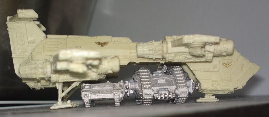

Unless my opponents have strong other feelings on it I think I'll go down the route of preventing LOS underneath them. It keeps things simple and abstract and we could assume the closer THTs draw the fire. Since THTs are large and come in formations of 2-3 they could potentially block LOS to quite a large area of the battlefield though, will have to bear this in mind during testing.
This photo illustrates why it does seem feasible to shoot underneath a landed THT (a Manta would be a much larger again example):

In the world of proxies, take your example, what if your opponent doesn't have an exact model with that gap underneath? He gets to block LoS with his proxy Thunderhawk Transporter while you don't.
TLOS tends to create more problems than it solves, using the model shape provides to many variables. Additionally, while the miniature may be static, battle is fluid, the Thunderhawk is going to drop off its cargo and take off as fast as it can, because to remain static is suicide. (this may be the effect/tactic your after, but I am sure your troops would hate you for it).

Glyn, I'd certainly prefer LOS to be blocked by the general presence of the model.
As in no peaking through legs or under Landers or even under the Manta skimmer.
I imagine the legs being in motion, shooting through (well targeting to shoot through) would would seem a spectacular ballistic skill.
The down thrust jets on a lander could easily obscure the forces behind them.
I imagine the anti-grav field distortion below a Manta or Engine of Vaul would do enough to warp space-time between the vehicle and planet.

With a game that has both a large level of abstraction, and a sliding ground scale as discussed in the book, I don't think you can ever apply TLOS to the game.
WE's block line of sight regardless if you can put your eye and table level and see under it.

Agreed guys. While TLOS has some appeal, it is too fiddly and I cannot recollect ever seeing it played.
Having some form of empty base for landed transports does make a lot of sense and is something I might try, as all my other ground stuff is based. It would also allow a nice visual distinction between 'flying' mode and 'landed' mode.
