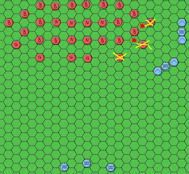

Here's a sample assault using the rules:
A huge ork mob, vs a marine tactical and marine dev detachment.  (scale: 1 hex = 2.5 cm)
The marine devs move in and shoot at the orks, killing two grots and a boy, and causing 2 BM.
The marines retain and engage with the tactical squad.

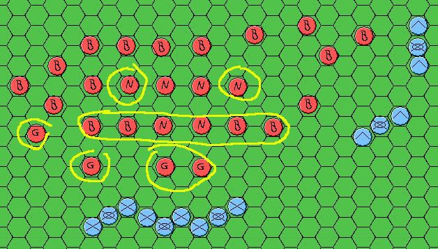

The orks counter charge, with those managing the make it into firefight range circled in yellow.

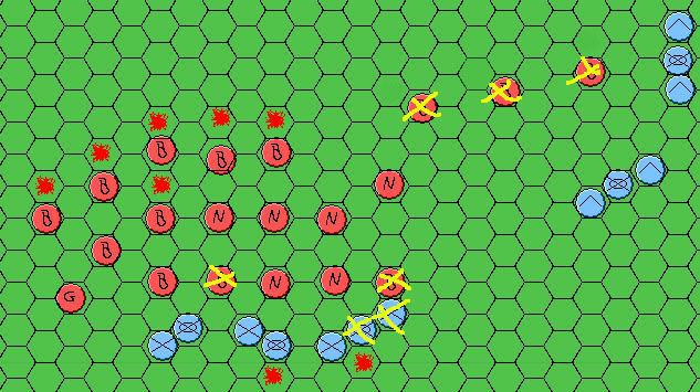

The orks kill 2 marines, the marines kill 3 grots.  The Devs fire in support and kill 4 boys.
On the roll off:
The marines have 4 kills, plus 1 for having no blast markers, and +1 for the other side having more blast markers
The orks have +2 for kills and +2 for outnumbering.
Advantage marines at +2.
Marines get a 4, orks get a 6, so neither side gets extra blast markers.
The marines could counter charge, but decide to stay still.  The orks counter charge.

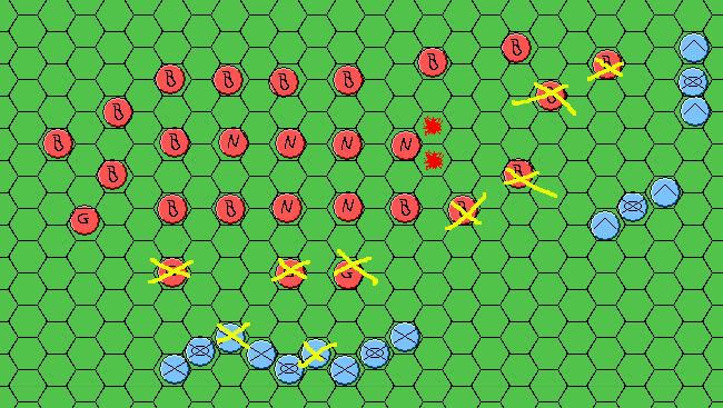

The orks kill a marine and a rhino.  The marines kill 2 boys.  The devs provide supporting fire and kill 3 boys.
Roll off:
Marines have 5 kills, orks have more blast markers
Orks have 2 kills, still outnumber 2 to 1 (+2).
Advantage marines, +2
Marines get roll 6, orks get roll 4.
Orks get 4 more blast markers.
This is just enough to break the orks, iwth no hackdowns.  Had the orks held out for the 3rd turn of close combat, they might have actaully wiped the marines out, as they would be in base to base with several units.
Orks leave with 6 nobs, 8 boys, and 1 grot
Marines leave with 3 marines, 2 rhinos, and 4 blast markers.
The only real difference in the 1st test run with the new combat system is that the orks didn't suffer 4 hackdown hits.
Will have to try some more tests where the orks are in full base to base formation, since that will maximize the effect of their close combat ability.

You do realise that in your diagram two of the boys could have contacted the devs (counter charge is to the nearest formation).
