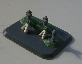

Some Work In Progress.
Thudd Gun
Mortar Squad
