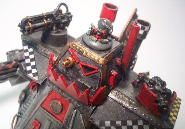

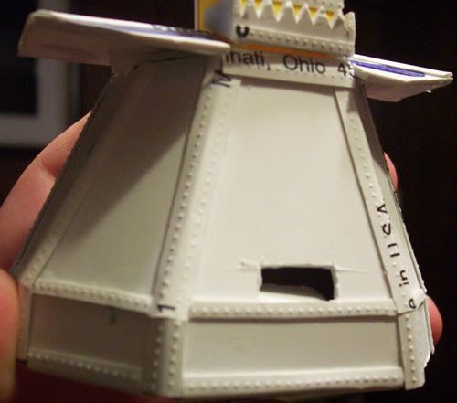

I used a pounce wheel through thin plasticard for my rivets.  Here's an unpainted and a painted pic, so you can get an idea of how they look:
