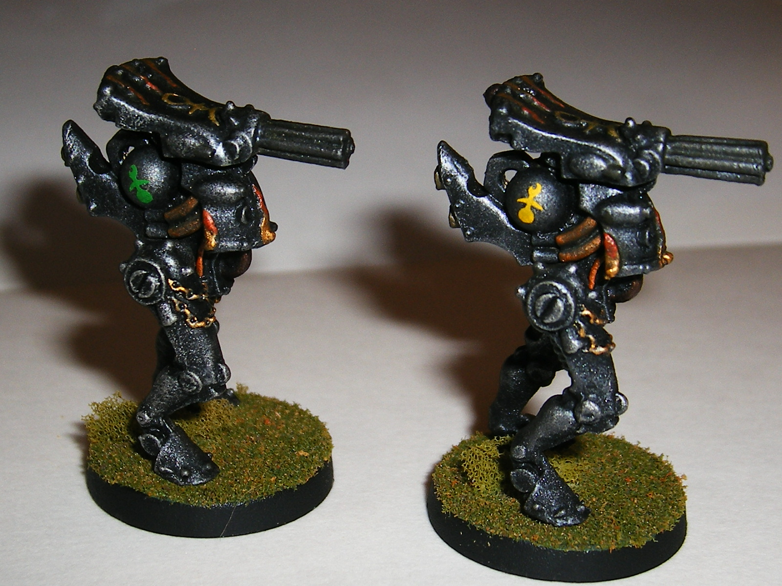

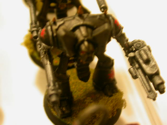

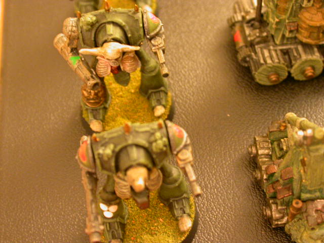

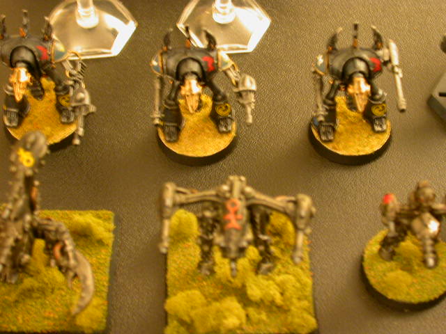

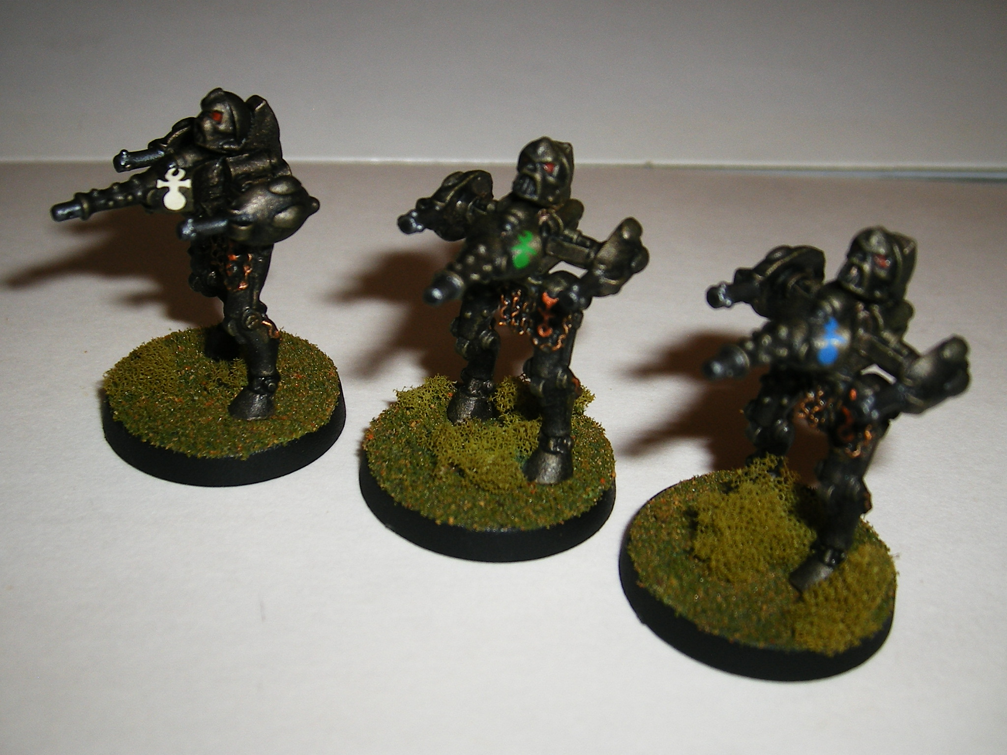

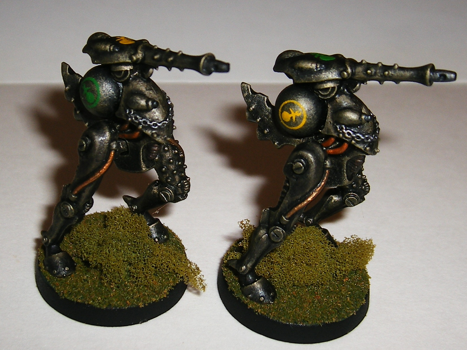

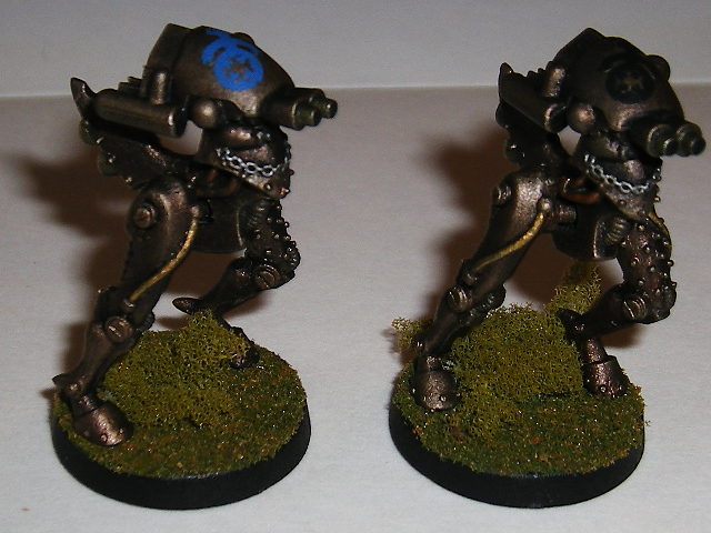

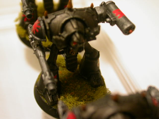

I very much dislike Knights. They look too much like a guy in PA. Unless you count the first GW release of Knights, which couldn't have been More Awful ! :o ... So I converted the ones I got with TL to Chaos ... Seemed like a good thing to do with them, IMO ... 8) May give some a few ideas ? [Got to take newer pics too ! :-[ ]

Those are cool, looks like weapon swaps aren't to much trouble. I was thinking of later finding some better proxies for Slaanesh and Eldar knights :p, but those are good for standard chaos knights.

Thank you ... Yes, it is fairly easy to swap out weapons, etc.

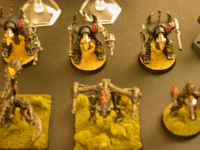

Slaaneshi you say ... I "up graded some" of those too ... 8)
