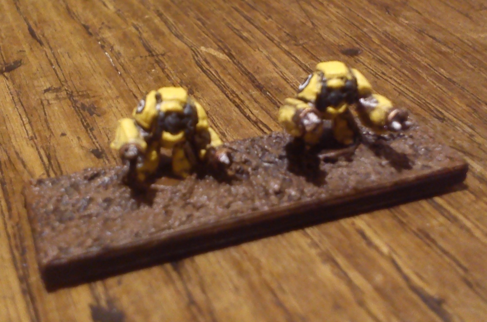

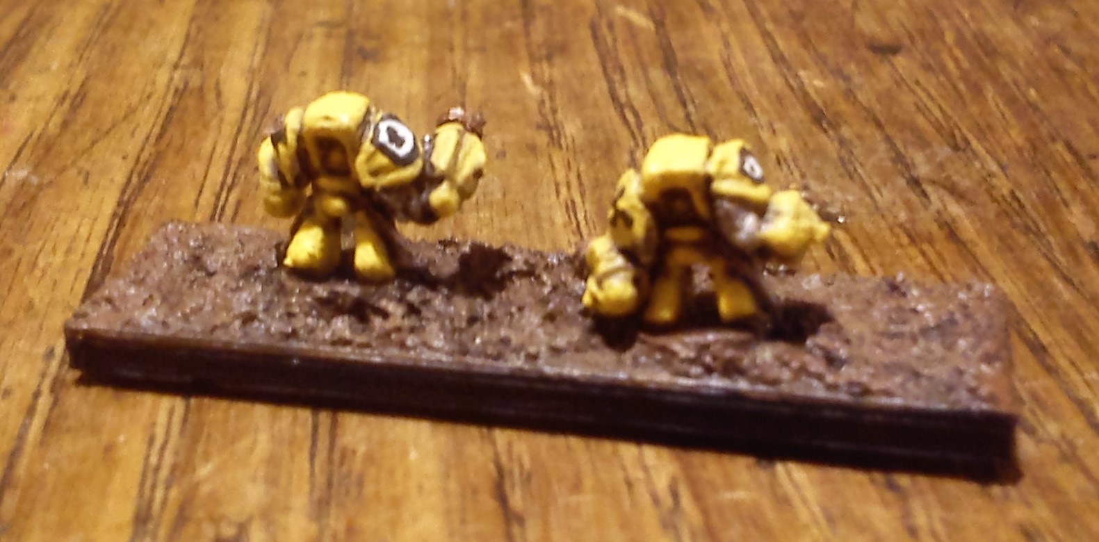

Very nice conversion Apoc, I used the old plastic terminators for mine and their a lot smaller.

neat, what did you make the arms from?

Sorry for the delayed reply, they are the terminator's arms with the old plastic guard shoulder mounted lascanons.
