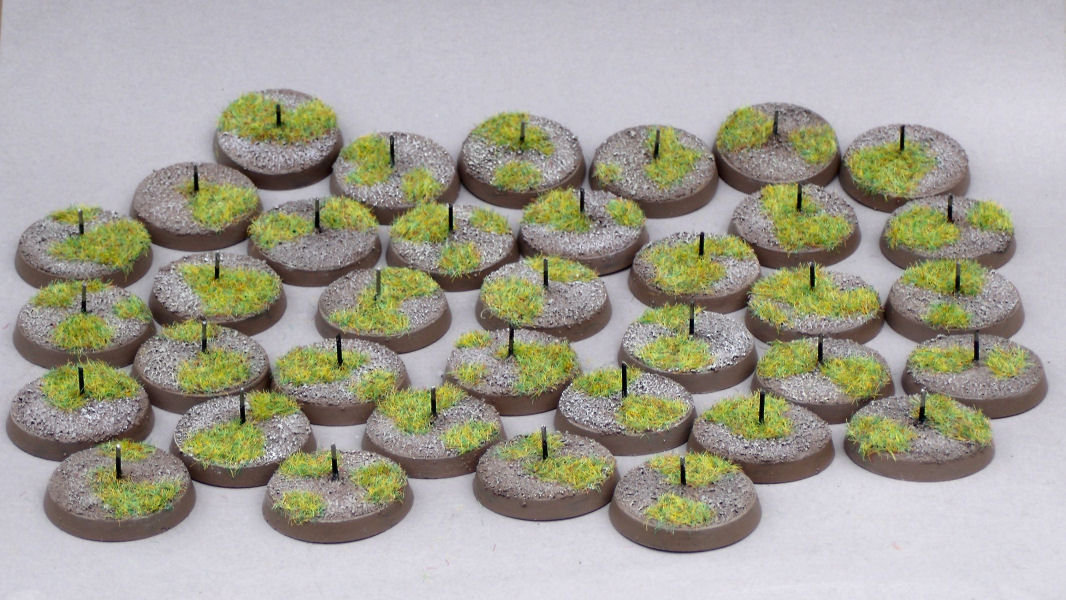

I made these from 25mm bases and short lengths of piano wire. I haven't glued the vehicles in place, just drilled holes for the stands to slot into. That way I can remove the bases for storage/transport.
(Click for larger image)
I've been trying to decide on a way to do this for flyers that doesn't involve magnets (which for some reason I just can't get to work). Is pressure fit enough to keep the models on during play?
