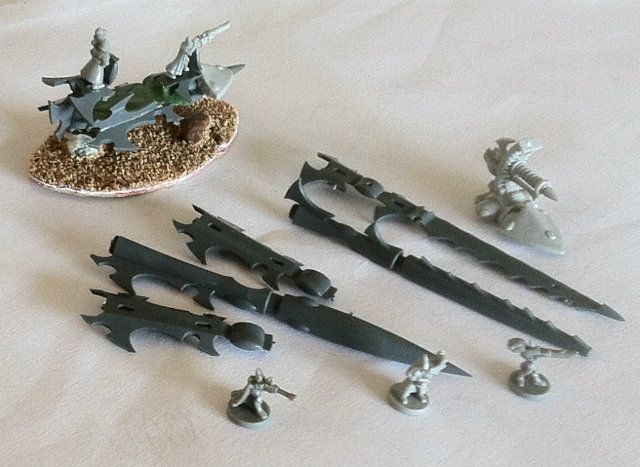

First pic; pieces needed are these:
What you see above are.
One eldar ranger,
old plastic gun crew,
old plastic shoulder mounted heavy weapon guardian,
old vibro cannon/support weapon,
one new 40k DE razorwing necrotoxin missile (unassembled),
1,5 new 40k DE razorwing shatterfield missile,
Some kind of base (technically not necessary by the rules, but makes a skimmer look a lot better).

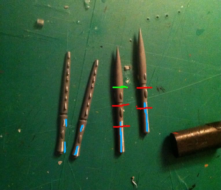

II) Step two. Cut the necrotoxin missile part like in the below picture.
III) Cut of the frontal part of the vibro cannon. Glue it together with two of the parts from step II. Glue them straight and not asquint like I did in the picture :{[]
IV) Cut shatterfield missile part like this
IVb) Below pieces goes together. Som flattening of their surfaces are needed to easy and convenient glueing.

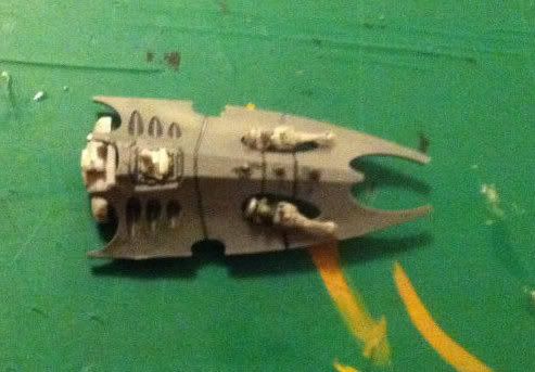

V) The smaller two paired parts goes to the front. The bigger part from the shatterfield missile should be placed to the back to give som "back fins" to the raider and on top of that glue the large part form the necrotoxin missile to form the raised area for the steersman. Fold it first before gluing it on
VI) Right vessel in pic: Take weapon crew miniature and cut of the feet from the base. Glue to the back. Take some small piece of suitable plastic and glue for the aft gunner to have his weapon rest on.
Left vessel in pic: Cut of weapon barrel part from shoulder heavy weapon dude and glue to rangers weapon instead of the thin part of his rifle barrel. Glut to the front. Add green stuff to floor can be done earlier.
VII) After green stuff is hardend you add railings. I used parts from the shatterfield missile.

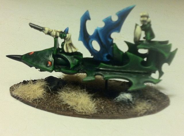

VIII)The finished product looks like this. I added a sail before painting it is made from wing parts from the 40k reaver. The 40k raider has a more traditional sail, but that wasn't really doable for me. They were way to thinn and fragile.
It looks a lot more bright green in the pic than it actually is. The green is rather dark looking realy.

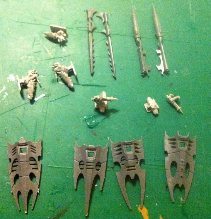

Parts that I've used can be seen in this picture.
What you see is:
1 old plastic epic eldar jetbike.
2x old plastic epic eldar vyper jetbikes.
2x old plastic Vibro cannons (mine are somewhat cut up).
2x necrotoxin missile part
2x shatterfield missile part
2x 40k reaver jetbike hull part (4 are shown)
