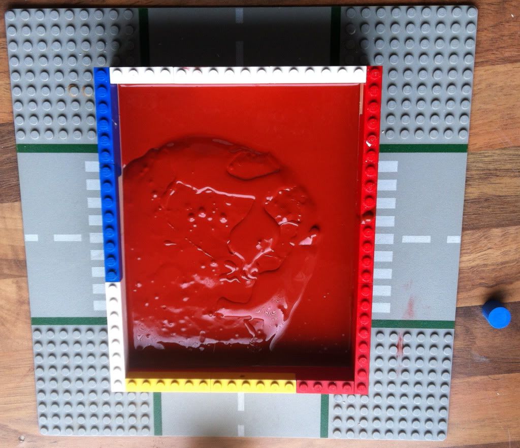

I have for a while been trying to aquire some hungry beasts off of ebay. Which as, far as the tin models goes, can be done at reasonable prices. All the plastics I've been trying to bid at has gone wildly high. I, for instance, bidded 124£ for an auction of 17 sprues. I wasn't even close. It's ridiculous how high they go. To find a way around this, and just because I've wanted to try moldmaking for a while, I've started project "Täranider".
I've never tried silicone mold-making before, so I see this as primarily a learning experience. I going to try and make a home made "injection-mold".
First attempt, "Sprue as is", I've not added or cut away any parts of the sprue/"pouring channels". This probably will not work, but I wanted to try it before starting to cut the sprue in pieces (actually only have one). Pictures with mobile phone, so not the best quality.
Preparations
Next step mixing and pouring the silicone:
Lessons learned during above step.
Read instructions carefully. When mixing catalyst and silicone don't stir/mix for three minutes because you think you remember that time when instructions says 1 minute.
The silicone was already quite hard when I started pouring and it didn't flow out well. I had to make more for a second pouring, like you can see. It also meant I ended up with a bunch of trapped air bubbles.
Step three Inspection after removing clay:
I have to cut away some small pices here and there like you can see.
A few air bubbles can be seen be seen. I'm not so worried though. I'm not planing on using very many of these, so if I can only use 3 per sprue then that's ok.
Second part of the mold will be made tomorrow.
cheers

Yeah I have made the second mold part and made a first testrun just to see were air would get traped. That showed me that I'm going to have to drill a new hole for the air outlet and injection point.
The mold got a bit damaged though. I forgot to prespray the mold with mold release so some thin parts pf the mold were ripped off.
Another problem that I encountered during the test was that I had some major flash. I couldn't apply a good even pressure because of the back being uneven on the first part of the mold (due to the failed mixing seen in the above picture).
Next step is to start cutting the sprue in smaller pieces and make seperate molds for hormagaunts, termagaunts etc. First resin molds and then I try molds for tin as well.
