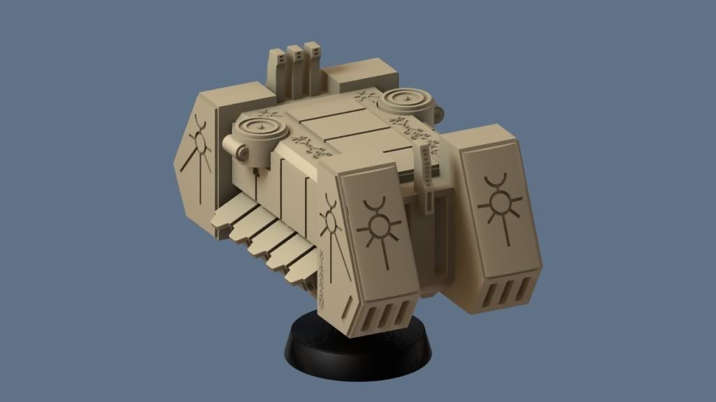

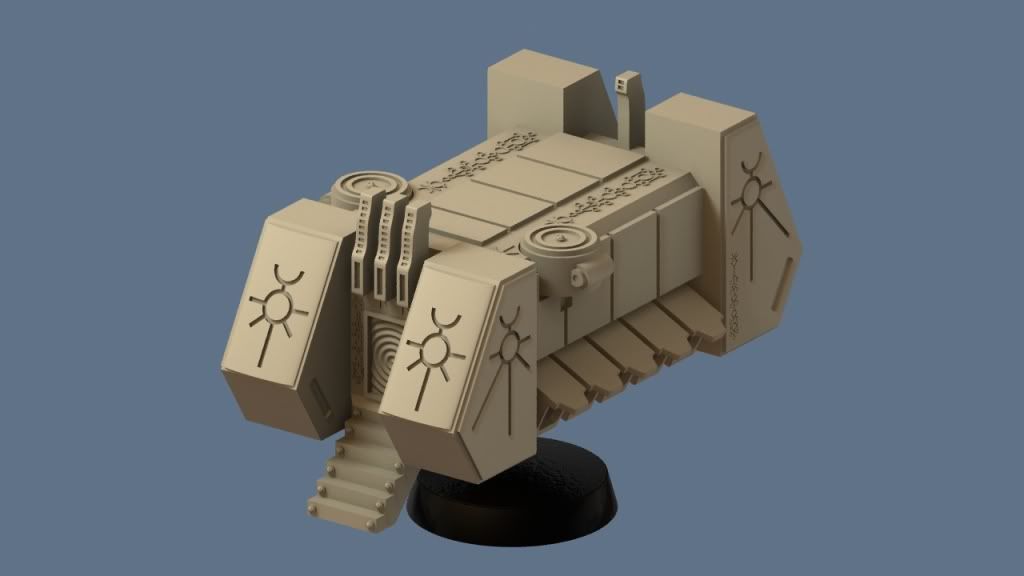

Hieroglyphics added! Need to add:
* mast' towers to the rear
* more nurnies & greeblies
* gun barrels to the side guns
* front cannons
* figure out where to mount the third guns
* add landing gear and
* add a portal-engine-drive-thing at the back.
http://i255.photobucket.com/albums/hh12 ... x/BBQA.jpg
http://i255.photobucket.com/albums/hh12 ... x/BBQ2.jpg
[b][color=#FF00BF]Chief DreadKnight Apologist[/color][/b]
 Post subject: Space Pharaoh's Monument
PostPosted: Fri May 01, 2009 3:00 pm
That looks fantastic!
Might need to be a little bigger to represent a 3DC war engine, but the *look* is great!

Yeah, it's basically 6cmx4cmx4cm volume wise I think, so it's pretty big (may have to reduce it for cost's sake)

Let's see, 96 cubic centimeters? These are estimates, but PrintAPart would charge you over $500 for that. AcuCast could probably do it for about $300, but their resolution is lower (but material is stronger).
Somewhere around here I have measurements for a Baneblade's volume...
Mold life will be improved if the glyphs are no deeper than they are wide. For example, a stroke .5mm wide should not be deeper than .5mm.
As a general rule of thumb, a change in elevation or stroke won't readily "catch paint" unless it is around .3 to .4 mm.
Your mileage may vary, I am not a professional, etc.
