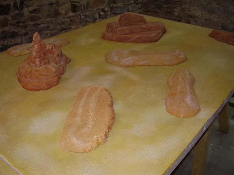

If you're worried about sand being too coarse (a problem I've encountered), I'd recommend using Sand for Children's play areas/sand pits; it's quite fine.  I used it on my desert boards:
The hills and mountains were made from polystyrene, cut with hot-wire cutters, then covered with sand and painted.
