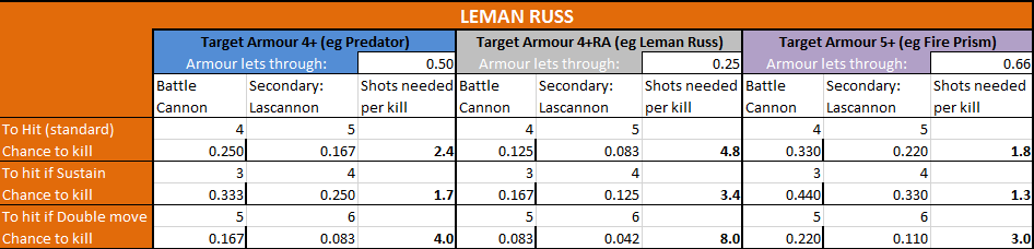

The Leman Russ
(note: about 62.5pts per tank, strategy rating 2, formation comes with commissar)
The antitank ability of the Hammerhead is not significantly better than the Leman Russ:
[] They both hit on 4+ with a 75cm maingun. The Hammerhead adds 1 to its to hit roll and a secondary 5+ shot if the target is markerlit.
[] The Leman Russ adds a secondary 5+ shot if the target is within 45cm, without any external requirements.
The result is a small advantage to the HH, provided it can manage to keep a markerlight unit close to targets.

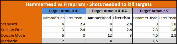

Here is a direct comparison of the Hammerhead to the Fire Prism
The below is a simplified table that just compares how many shooting tanks are required to kill each type of target.
Looking at how the tanks perform against Reinforced Armour (ie the middle column with a grey header)
[] With no modifiers if takes 8 Hammerheads to do the same damage as 2.4 Fireprisms. Fireprisms do 3.33 times more damage to RA than Hammerhead
[] A Fireprism that double moves and shoots does more damage to RA than a Hammerhead that sustains fire.
[] A Fireprism that double moves and shoots does more damage to RA than a Broadside that sustains fire on a target that is Markerlit
A Fireprism doing its most inaccurate shot while double moving does more damage to Reinforced Armour targets than a Hammerhead that has the perfect firing solution on Sustain and has a second formation at risk within 30cm of the target.
And that is why players so often report that Hammerheads under-perform, despite their being the superior Landraider/Leman Russ killer in 40K. It turns out it's not just all in their heads :D
