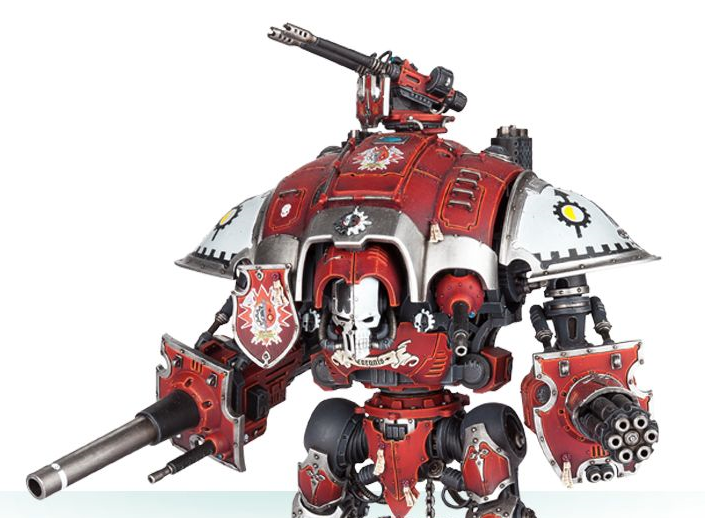

Knight AA upgrade: add a character upgrade of a ‘Twin Icarus Autocannon’: range 30cm AP4+/AT5+/AA5+ all-round arc for 25 points. Add one Twin Icarus Autocannon character to a Palladin in the formation. This upgrade would be available to as a 0-1 to Baron or Palladin households.

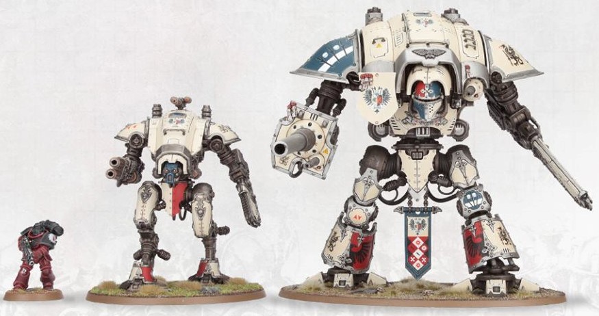

Add an Armiger formation under a separate Armiger subheading (where Retainers are now) stating up to 1 may be taken per household:
Knight Armiger AV 30cm Sv:5+ CC:5+ FF:5+
Thermal Spear 15cm MW4+ AND MW FF
Reaper Chain-cleaver CC +1 Attack, MW
Notes: Scout, Invulnerable Save, Walker.
225 points for 5?

- Armiger stats and costs are tentative, thoughts? It helps to have a scouting unit in the list and that is the role of this new 40k knight type so it seems appropriate to include them with the retainer scouts removed from the list. There’s a good proxy model to represent them these days but there’s plenty of other small knight proxies people could use or at a push be like ‘these Sentinels or Robots are counting as Armigers’ during the pre-game warm up.

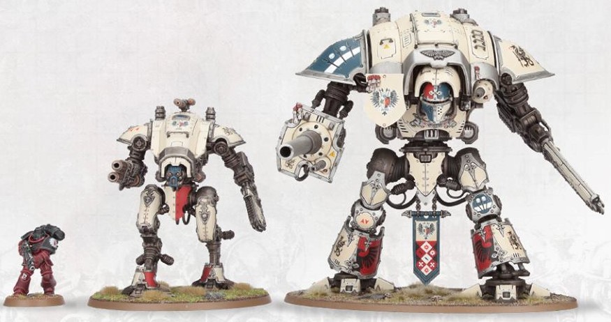

Knights and Titans fighting together is a classic combination in the game! - the original Adeptus Titanicus soon added Knights to use alongside the titans, the 2nd Ed Epic Titan Legions box was a Titan plus Knights army and the new AT is based around Titans plus Knights.
In real life there’s probably a LOT more new active AT players than there are current EpicA players globally. It’s a golden opportunity to recruit new players to try Epic when they realise it’s still being played and that their AT collections can also just as well be used for Epic (the larger models will be a trade-off in game terms). They’ll expect to be able to use an army of Titans plus Knights though and we could really do with lists that allow this and currently Epic-UK doesn’t.

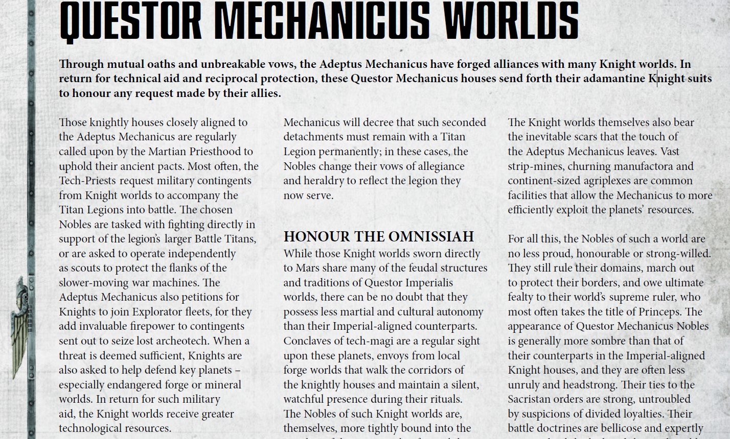

In background terms there are two distinct sorts of Knights in 40k – independent ‘Imperial Knight Worlds’ that manage their own affairs, rule their planets themselves, ect. These are represented well by the current Epic-UK and Net-EA Imperial Knights lists. Then there are ‘Mechanicus Knight Worlds’ which are very much integrated into and run by the Adeptus Mechanicus and their Knights regularly fight alongside the Titan Legions and visa versa. The 40k Knights Codex has several pages of separate background/images for each sort and if there’s just as much justification for having separate lists for both as there are for having variant IG or SM lists.
