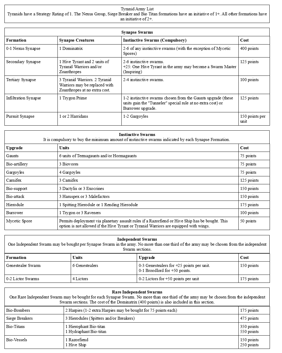

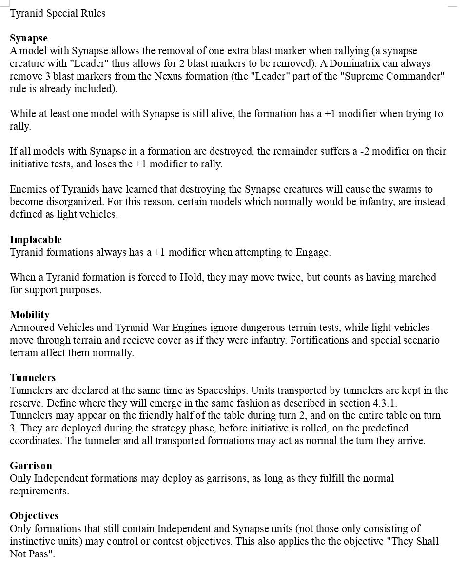

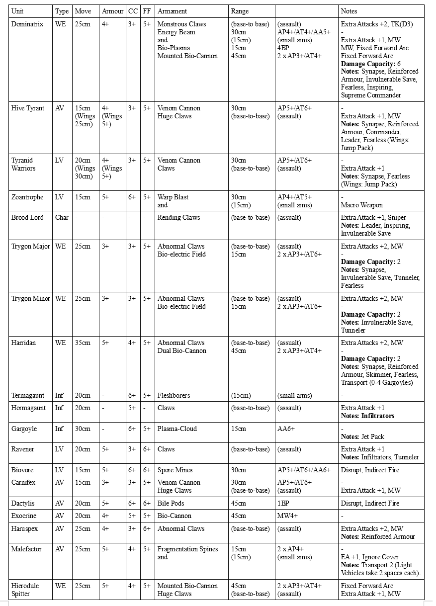

I have been looking at the French version of the Tyranids, and they've got some very interesting ideas on this topic. In their list, Termagaunts, Hormagaunts and Gargoyles function like normal units (giving blast markers etc) but do not count for combat resolution *if the Tyranid player initiated the assault*. Also, their Synapse rule allows for the removal of an additional blast marker.
Another nice rule is that they give the Tyranid player the option of moving twice when making a hold (but may not support engagements that turn). Played a game against Borka a week ago, and this second rule would really have helped him from being stuck in his deployment the first turn. Fits very well thematically with Tyranids being this horde that surges forward no matter what.
Other things that list has that I like is:
-Tyranid Warriors are light vehicles for targeting purposes (very thematic). Also, light vehicles can be transported, but counts double.
-Hive Tyrants and Tyranid Warriors can be given jump pack (for an armour penalty) Again very thematic, and makes Gargoyle swarms a lot more interesting.
The French army lists are found on this site: http://f-erc-codex-epic-armageddon.e-monsite.com/

I've done a partial, unofficial translation of them. The semi-expendable rule described above is not in these documents (should be part of the special rules but is instead on the unit description part that I haven't translated), Works as described in my previous post.
