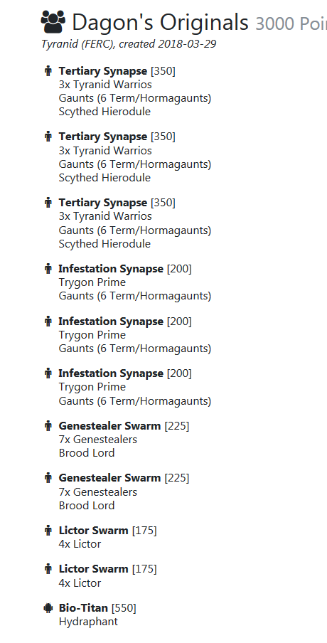

Took the 2013 version to play a tournament yesterday. Played against Steel Legion, E-UK Dark Angels and Tau. Three draws later and I finished in the middle of the pack. Would probably have won the first game had we been able to get into turn 3. Confirmed that the original list is perfectly playable, but does need a bit of tweaking. The list I played had basically no shooting at all, but lots of WE spread throughout the list. Three units of tunnelers in the list, which might have been excessive but made turn 2 quite fun.

Yeah, thoose damn Trygons showed up everywhere!

Post updated
