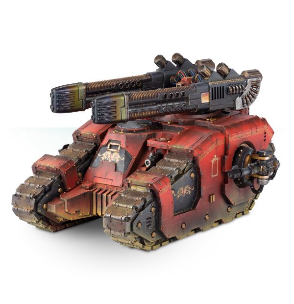

Example
Omega Tank Destroyer
2 Hullpoints
CAF +2 (Med tank +1, Marine +1)
Move 25cm
Armour save 2+
PD 2 25cm 5+ save 0 (4PD if side sponsons are heavy bolters)
Main gun 2 shots 25cm range, save -1 ,4+ to hit
Sustained burn 1 shot 25cm range, save -2 , 4+ to hit, +1 on hull point chart to roll again.
2 lascannon 50cm save -1 hit 4+
