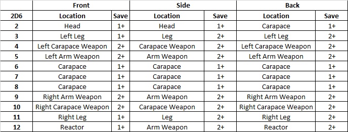

A 2d6 system was my first thoughts, something like this for a Warlord Titan:
It is very similar to what they use in Battletech and I can see Titans being more resilient because of it.
I wouldn't like to see specific armies get an advantage for targeting titans. How good a unit shoots is already included in their stats.
I did think about an option to aim or target if you are under First Fire Orders. Something like, you shot at a -2 to hit, but you may choose the location you hit on the titan. Obviously that makes weapons with low "To Hit" numbers quite good, but all the "To Hit" numbers are being reviewed under Platinum and I will be getting rid of lots of the 2+/3+ numbers. But some armies like Eldar which are likely to have a few more better to hit rolls than others might get a bit more out of it. Plus with it being a game wide rule, it doesn't have to be costed for an army.
Definitely wouldn't want to see different levels of criticals and damage on vehicles. In fact if we implement a Damage Point system as being discussed in another topic, we could most probably just rid of the Super Heavy Critical Table.

I like this very much Mattman and you're right the resilience of Titans would be greatly imrpoved by the fact that hitting the head or reactor would be difficult on a Warlord because you need to roll 2 or 12 on 2D6 which is fairly unlikely. It also means the removal of the reactors on the front of WRlords would be less necessary.
When designing tables for Warhounds in particular but also for Reavers, I'd like to see a higher chance of hitting the head, this reflecting that they are lower points costs and therefore easier to take down.
The option to fire at Titans with a -2 but resulting hits mean that the player can pick which location is a great idea also and means that we are not unfairly penalising certain armies as you point out.

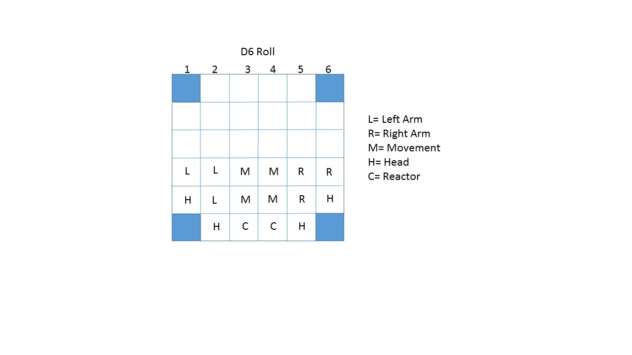

I like the system war machine uses for the jacks, you would have a damage grid and when damage is done you roll a D6 for the column the damage is applied. At the bottom of the columns is locations or limb indicated with a letter once all of the lettered(L for left arm, R for Right, so on and so on) once all of a certain letter is crossed out that location is lost or the titan suffers some sort of penalty. the roll is placed on a column and is fully applied to this column any excess is applied to the next column on the right, at 6 it goes back to 1.
