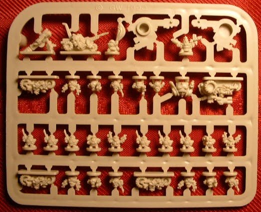

Warrior Heavy Weapons
Looking through the published lists, the backbone formation comprises stands with AP/AT shots.
Tactical Marines - AP5+/AP6+
Imperial Guard - 1/2 AP5+/AP6+
Ork Boyz - AP6+/AP6+
Chaos Marines - AP5+/AP6+
Guardian Heavy Weapons Platform - AP5+/AT5+
Half a Heavy Bolter puts Squat Warriors them on-par with Siegemasters Siege Infantry (who ARE designed to be woefully under-equipped) or Tau (who don't carry Heavy Weapons).
So, is the list intentionally designed to be a low firepower list? Hmm?
"But I think you'll find the models..."
So if you state your reasons are pednatic model-rep then you'll go insane if you consider...
Ork Big Shoota - actually a Plasma Cannon
Chaos Space Marine Missile Launcher - actually a Heavy Bolter
Space Marine Terminator Assault Cannon - actually a Storm Bolter
Space Marine Scout Heavy Bolter - actually a Bolt Pistol
The "Missile Launcher" or "Autocannon" is not always literally a Missile Launcher or Heavy Bolter, but a generic set of stats to represent a mix of heavy weapons. It represents the unit's ability to fire AP and AT shots.
If you still don't understand the abstraction the stats represent, then you can just arm your Warrior stands with the Missile Launcher models. Problem solved.
Half a Heavy Weapon?!
Where has this come from? It's not previous editions - Ork and Squat Warlords explicitly stated one in every five models should have a Missile Launcher. It's not sprue representation - there's enough Heavy Bolters to give every Warrior stand a Heavy Bolter.
The Squat Warriors need upgunning to a Missile Launcher/Autocannon per stand.
How that affects the game
That turns the Warrior formation into a decent choice, rather than a waddly little bunker to put the Grand Warlord in.
Because in my games, these chaps are an awful short-ranged firebase. They pump out one more shot than a 4-strong formation of Marine Scouts. They're difficult to position with their 10cm movement and poor range. And when you finally do get them there, their firepower is dismal. What's the point?
Give them a Missile Launcher each and WHAM! they'll become a toothy formation opponents will have to actually bother with.
Of course, this would mean a points bump and/or a size reduction .

Dave wrote:
It is a sprue representation though because you can't give every Warrior stand a heavy and still be able to make a Thunderer with the same sprue.
This sprue?
Rules say you mounted one heavy per Warrior stand.
