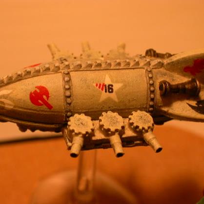

I use 2 type of models for the Overlord ... one for my Squats and one for their "cousins"/Allies - the Khazari. I use the same rules for each of them ... ;D
As far as rules, I'm not entirely clear on which version you are using. But not matter maybe this input will help. If not ... ignore it. And just look at my models ... ;)
Use the long range firepower at ... long range.
Use high terrain to cover the ship whenever possible. The easiest way is to use the height of the Overlord flight base for it's "altitude". I'm sure a Blimp can change it's altitude like any other aircraft. I've seen the Goodyear Blimp a number of times in flight. With it's hanger in Akron, OH being only 50 miles away. From where I live. It can fly pretty low.
Keep the Damage Rating at least DC3 ... to give it some survivability ...
