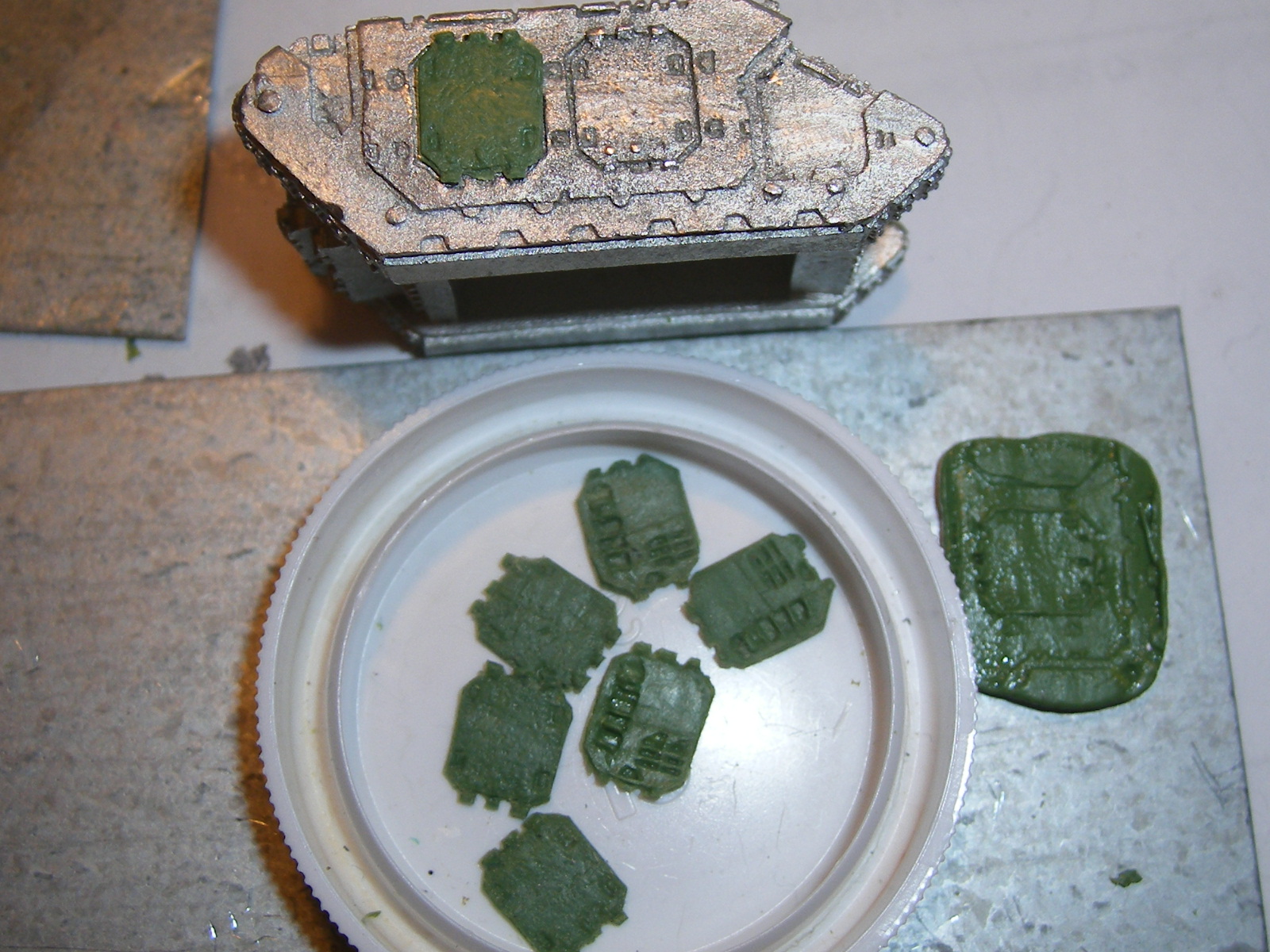

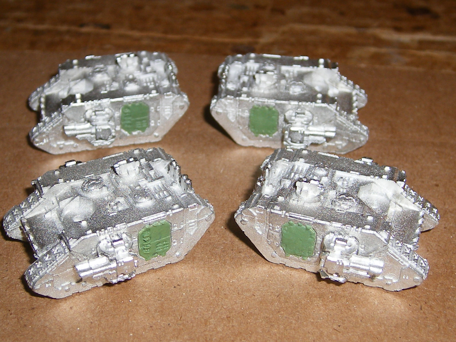

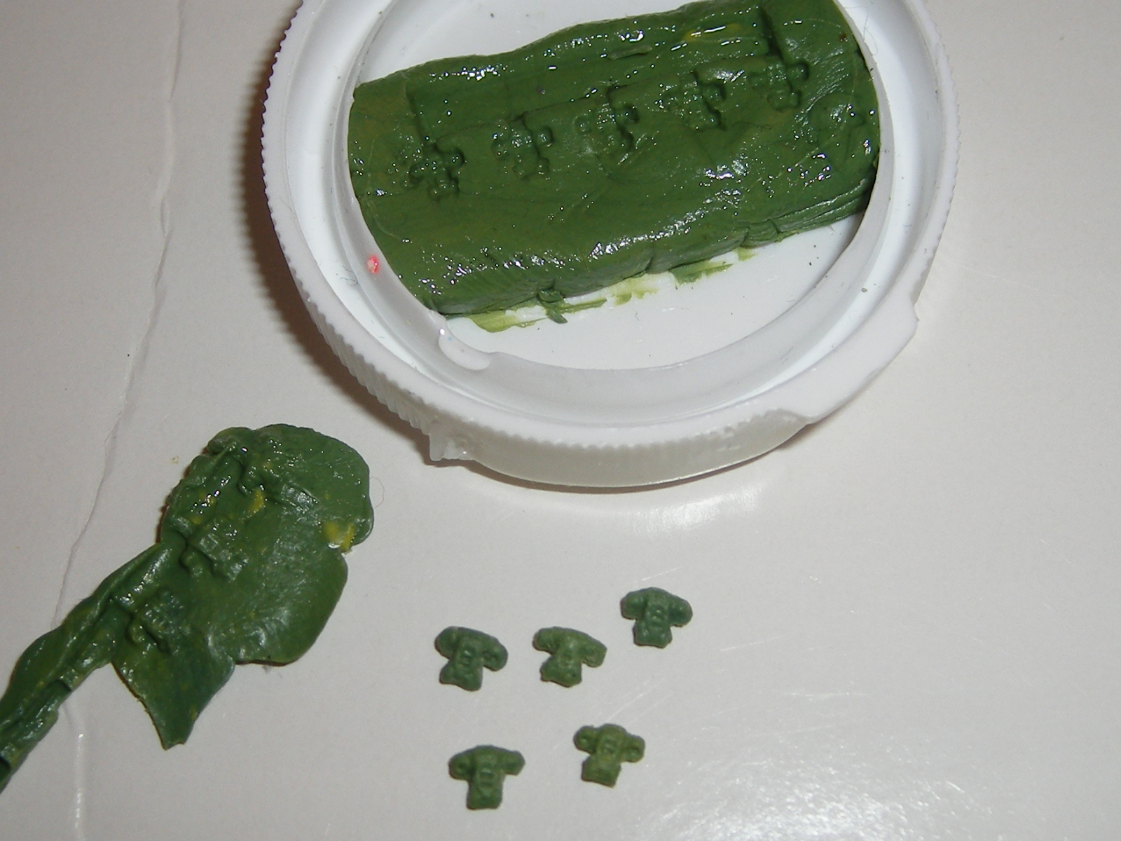

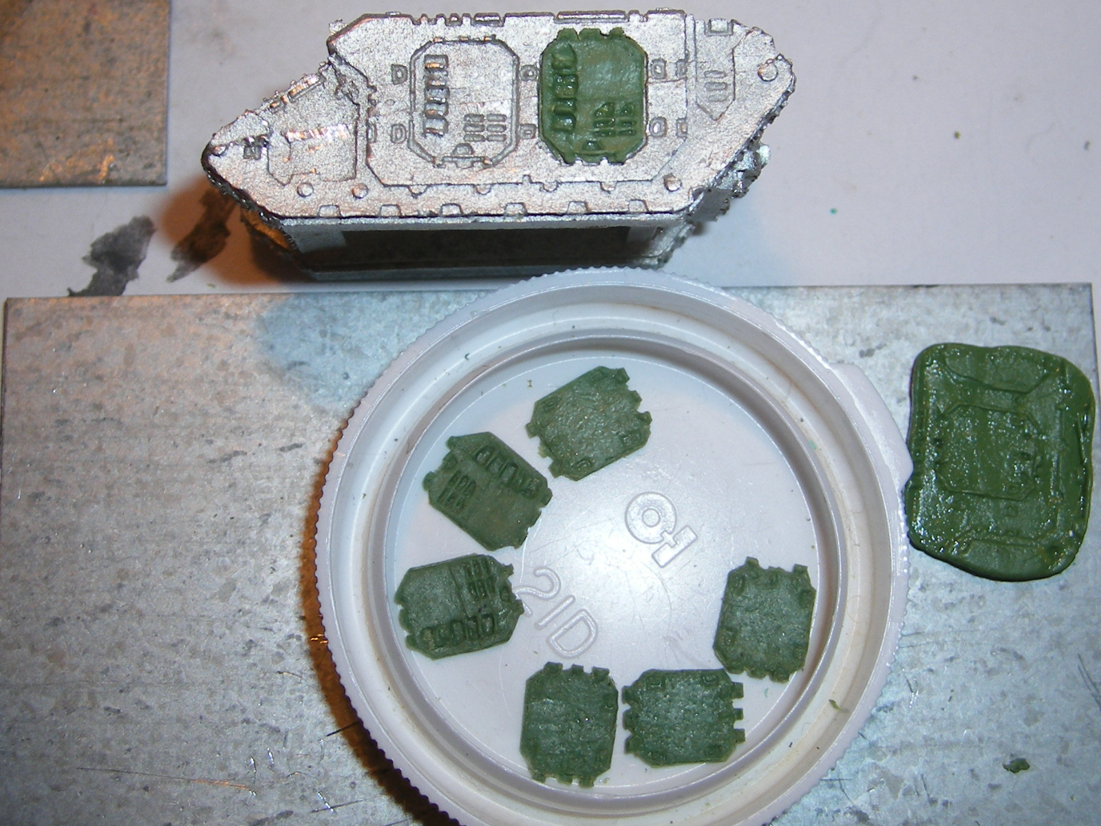

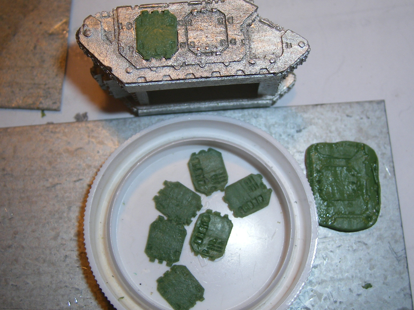

Some pics of my 1 piece molding ...
Some day I'll figure out how to put them in order ... :-X
