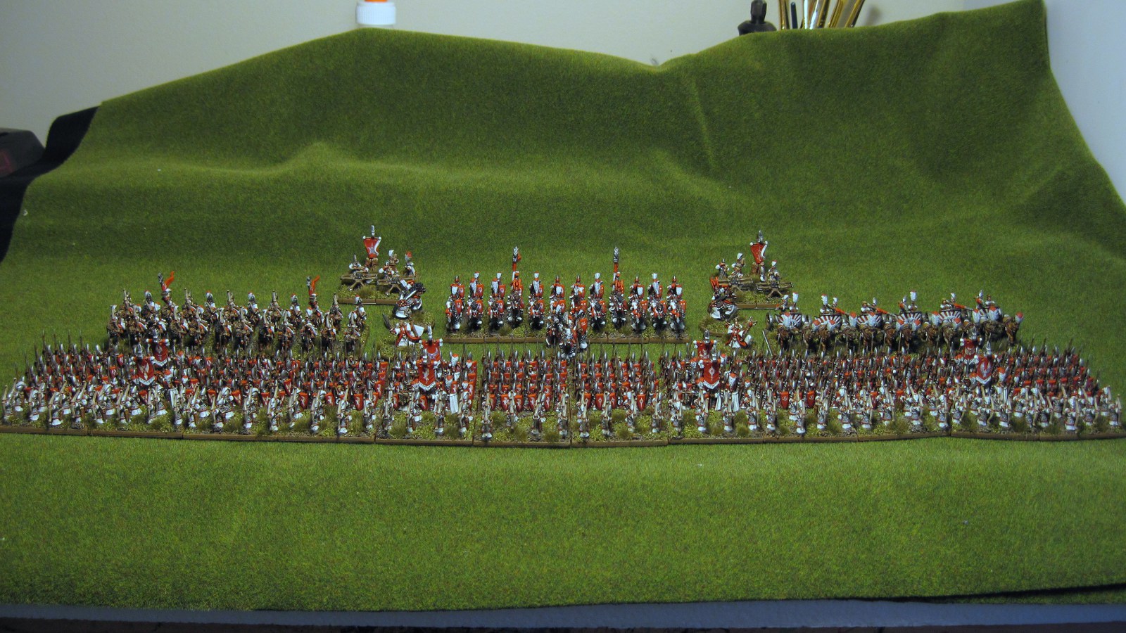

MicroSet is what makes the decal stick better, MicroSol is what softens it so it conforms to non-flat surfaces.
I usually gloss coat, brush on MicroSet, put the decal on, wick away the water with a paper strip or a brush, let it dry a bit, and then brush on as many coats of MicroSol as I need to make it lay flat. Sol really softens the paper, so you have to be careful you don't tear it.
That's how I did it for these anyway:
