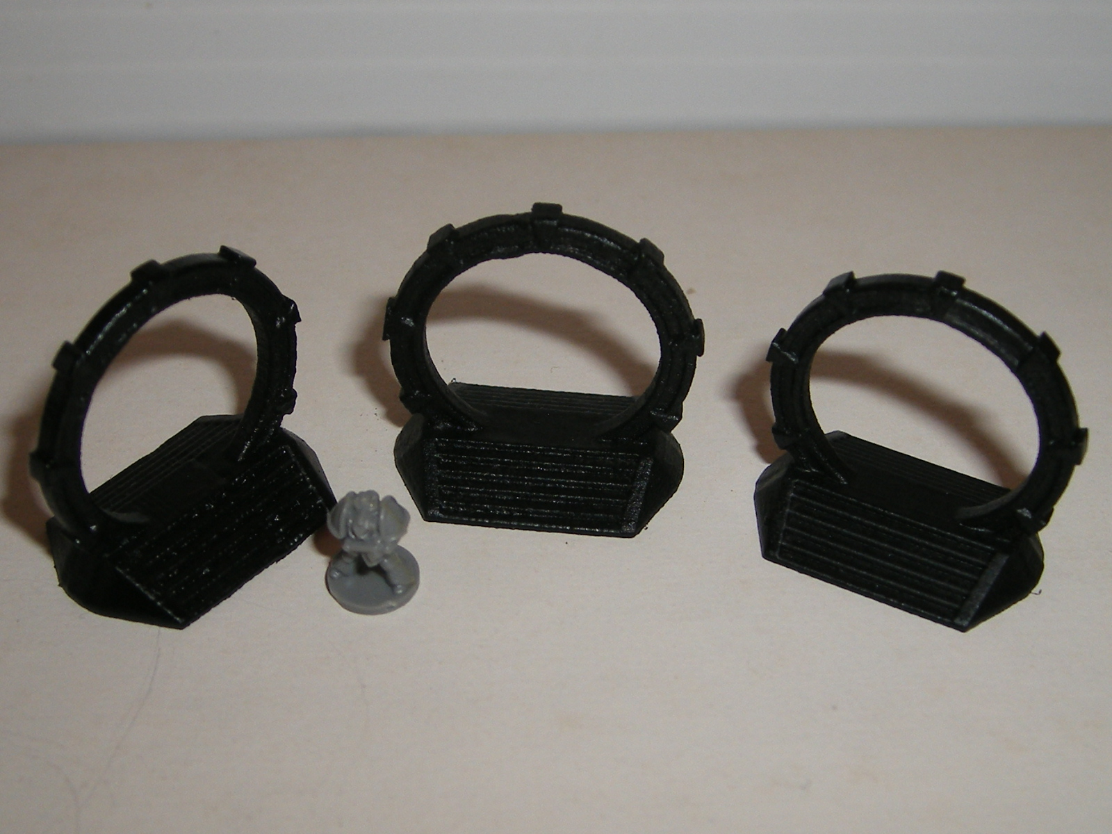

I have some small Stargates made from Shapeways in FUD, I base painted them black though ... but to answer most of your questions ... Shapeways FUD material is getting better in terms of both
paint-ability and resolution. Printed some
pieces with it and gave them a quick prime-and wash, looked good.
In fact, that's a new hobby angle - to make 6mm fun stuff optimized
to take advantage of 3D printing without having to worry about mass
production.
